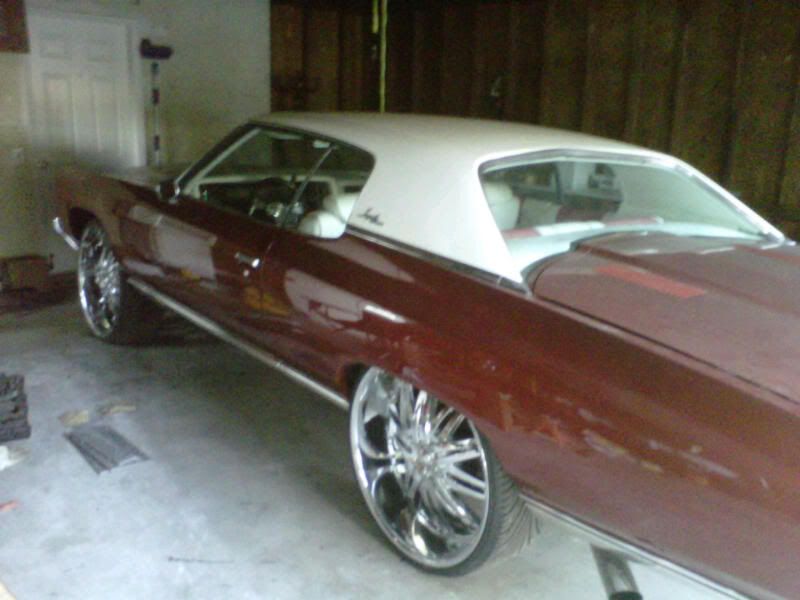

Im having a hell of a time fitting these 6s on my Impala! Now the tire turns a quarter way and wont turn any farther cuz its hittin the rear of the front fender well hard! They just barley pass the front bottom of the front fenders. I already have lifted the front with UCLs front lift springs...
71 Impala
26s with 265/25/26 tires
1" wheel spacers
UCL lift springs up front
rear is stock height
Ill get some pix up l8. Plz help

Yes and they have to stay cuz there wheel adapters. But from watching the wheel turn it doesent seen to be te wheel adapters causing the problem...

The spacer/adapter maybe pushing the wheels out far enough that when it turns it snags on the fender. That's why I only buy wheels w/the right bolt pattern.

Yep offset becomes pretty critical when trying to stuff the bigger wheels on these cars

Yeah I fawked up and got the wrong lug in a trade for some 22s I had. My only option at this point is to have the rims filled and redrilled or start cuttin. That's all I can think off...

or flip 'em and get you some that's the right bolt pattern and offset

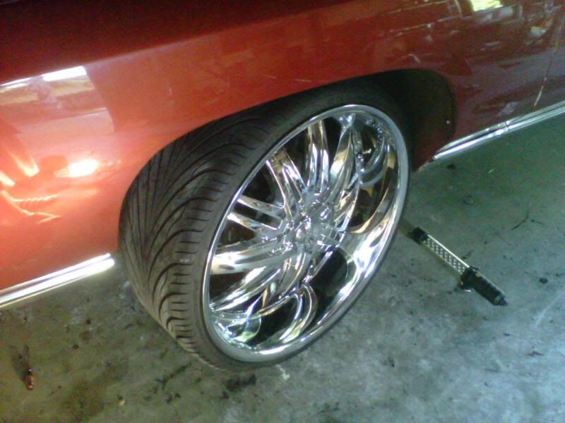

You can see it hits that bottom courner. How much do you think I would have to trim to get pass it? Would extending my upper control arms give me a little more lift to maybe clear it?

I dont even think you have to lift to do 6's on donks, maybe new springs and 1 knuckle but not much

Will say I have seen some of them cut the inner fenderwells though. IMO not a good move cause all of the dirt, water, mud, road grim gets thrown into the door jamb. Atleast it did on my cutlass, live and learn

I would jus cut to clear bud. like everyone said, it's gonna be a bitch without the right bolt pattern wheels bro.
